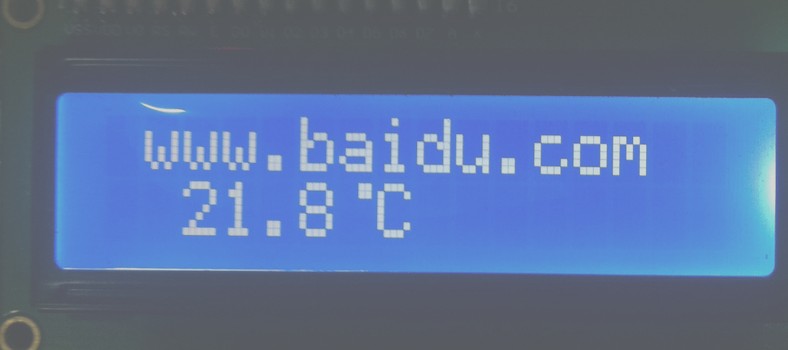

轉(zhuǎn)自:http://m.raoushi.com/mcu/2576.html

  zf_1602(4,1,'.');
  zf_1602(6,1,0x01); //攝氏度的點(diǎn)
  zf_1602(7,1,'C'); //大寫的C
  zfc_1602(1,0,"temperature:");
  while(1)
   zh(wd());
