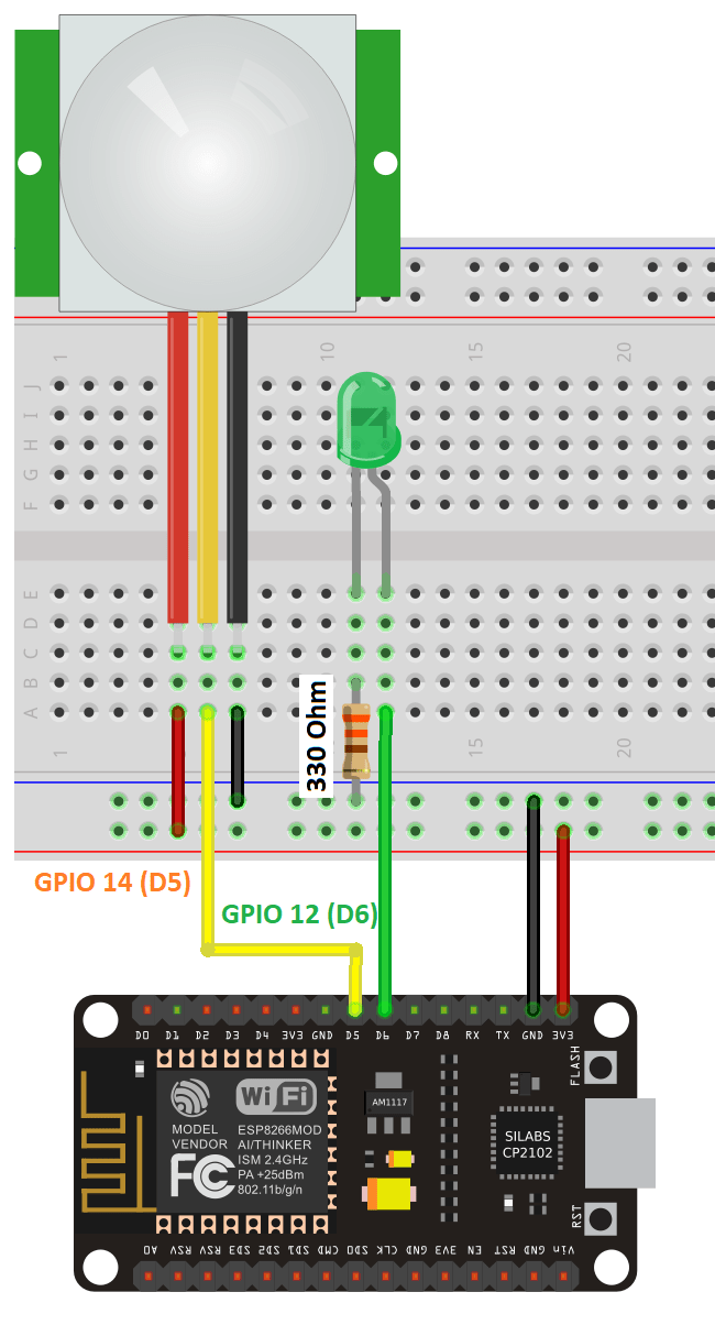

  1. #define timeSeconds 10
  2. // Set GPIOs for LED and PIR Motion Sensor
  3. const int led = 12;
  4. const int motionSensor = 14;
  5. // Timer: Auxiliary variables
  6. unsigned long now = millis();
  7. unsigned long lastTrigger = 0;
  8. boolean startTimer = false;
  9. // Checks if motion was detected, sets LED HIGH and starts a timer
  10. ICACHE_RAM_ATTR void detectsMovement() {
  11.   Serial.println("MOTION DETECTED!!!");
  12.   digitalWrite(led, HIGH);
  13.   startTimer = true;
  14.   lastTrigger = millis();
  15. }
  16. void setup() {
  17.   // Serial port for debugging purposes
  18.   Serial.begin(115200);
  19.
  20.   // PIR Motion Sensor mode INPUT_PULLUP
  21.   pinMode(motionSensor, INPUT_PULLUP);
  22.   // Set motionSensor pin as interrupt, assign interrupt function and set RISING mode
  23.   attachInterrupt(digitalPinToInterrupt(motionSensor), detectsMovement, RISING);
  24.   // Set LED to LOW
  25.   pinMode(led, OUTPUT);
  26.   digitalWrite(led, LOW);
  27. }
  28. void loop() {
  29.   // Current time
  30.   now = millis();
  31.   // Turn off the LED after the number of seconds defined in the timeSeconds variable
  32.   if(startTimer && (now - lastTrigger > (timeSeconds*1000))) {
  33.     Serial.println("Motion stopped...");
  34.     digitalWrite(led, LOW);
  35.     startTimer = false;
  36.   }
  37. }
