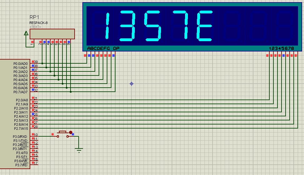

按一次鍵,開始按秒速依次顯示1357EFH,再按一次鍵清屏,如此反復。
  1. #include <reg51.h>
  2. typedef unsigned int u16;
  3. typedef unsigned char u8;
  4. sbit S2=P3^0;
  5. u8 code display[]={0x06,0x4F,0x6D,0x07,0x79,0x71,0x76,0x38};//1357EFHL
  6. u16 i;
  7. u8 j,s;
  8. bit KeySec;
  9. bit flag;
  10. void InitTimer0()
  11. {
  12.     TMOD = 0x01;
  13.     TH0 = 0xFC;
  14.     TL0 = 0x18;
  15.     EA = 1;
  16.     ET0 = 1;
  17.     TR0 = 1;
  18. }
  19. void key_scan()
  20. {
  21.         static bit sign;
  22.         static u8 count;
  23.         if(!S2)
  24.         {
  25.                 if(++count>=10&&sign==0)
  26.                 {
  27.                         sign=1;
  28.                         KeySec=~KeySec;
  29.                 }
  30.         }
  31.         else
  32.         {
  33.                 sign=0;
  34.                 count=0;
  35.         }
  36. }
  37. void main()
  38. {
  39.         InitTimer0();
  40.         while(1)
  41.         {
  42.                 if(flag)
  43.                 {
  44.                         flag=0;
  45.                         key_scan();
  46.                         if(KeySec)
  47.                         {
  48.                                 P0=0x00;
  49.                                 P2=~(0x01<<j);
  50.                                 if(j<=s)
  51.                                         P0=display[j];
  52.                                 else P0=0x00;
  53.                         }
  54.                         else
  55.                         {
  56.                                 P0=0x00;
  57.                                 s=0;
  58.                                 i=0;
  59.                         }
  60.                 }
  61.         }
  62. }
  63. void Timer0Interrupt(void) interrupt 1
  64. {
  65.         TH0 = 0xFC;
  66.         TL0 = 0x18;
  67.         if(++i>=1000)
  68.         {
  69.                 i=0;
  70.                 if(++s>=7)
  71.                         s=7;
  72.         }
  73.         flag=1;
  74.         j=++j%8;
  75. }
