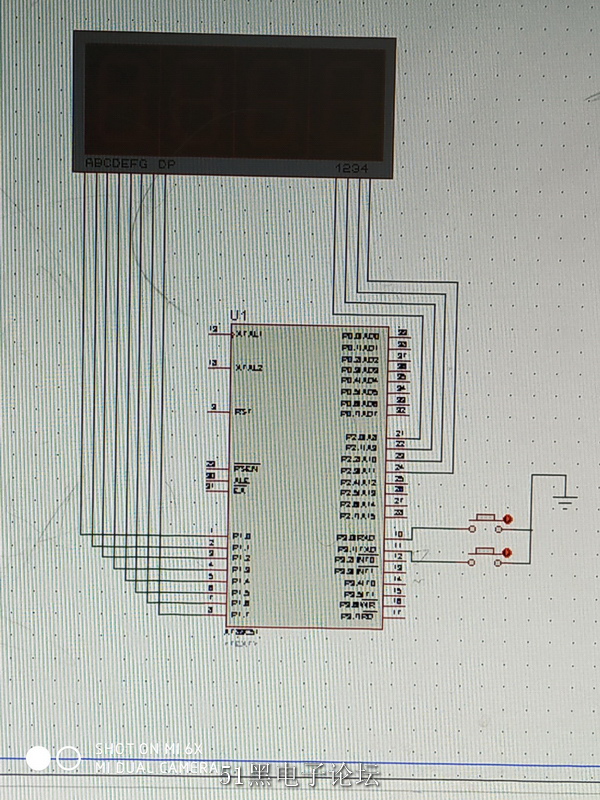

有問題 顯示結果初始值不是00:00 求學霸幫忙修改
ID:351226 發表于 2018-6-14 22:28 | 顯示全部樓層 |閱讀模式
#include<reg51.h>#define uchar unsigned charuchar duanma [10]={0xc0,0xf9,0xa4,0xb0,0x99,                  0x92,0x82,0xf8,0x80,0x90};uchar weima[4]={0x01,0x02,0x04,0x08};uchar jishu1,jishu2,miao,haomiao;uchar xianshi[4]={0,0,0,0};bit kaiting = 0;sbit k1=P3^0;sbit k2=P3^1;void yanshi20ms (void){   uchar i,j;   for (i=40;i>0;i--)   for (j=250;j>0;j--);}void chushihua(void){TMOD=0x01;TH0=(65536-10000)/256;TL0=(65536-10000)%256;EA=1;ET0=1;TR0=1;}void main(void){  uchar saomiao;  miao=0;haomiao=0;  chushihua();  while(1)    {           P3=0xff;           saomiao=P3;           if(saomiao!=0xff)           {             yanshi20ms();                 saomiao=P3;                if(saomiao!=0xff)                 {             if(k1==0)                    {                           kaiting=~kaiting;                        }                 if((k2==0)&&(kaiting==1))                    {                           miao=0;                           haomiao=0;                        }                 while(P3!=0xff);                 }           }        }  }  void miaobiao(void)interrupt 1{TH0=(65536-10000)/256;TL0=(65536-10000)%256;xianshi[0]=duanma[miao/10];xianshi[1]=duanma[miao%10];xianshi[2]=duanma[haomiao/10];xianshi[3]=duanma[haomiao%10];jishu1++;if(jishu1==4)jishu1=0;P2=weima[jishu1];P1=xianshi[jishu1];jishu2++;if (jishu2==100)   {     jishu2=0;   if(kaiting==0)       haomiao++;     if (haomiao==100)      {       haomiao=0;       miao++;       if(miao==60)              miao=0;      }   }}
ID:342822 發表于 2018-6-15 00:09 | 顯示全部樓層
在元件庫搜1row-4col-red將這個原件放在4位數碼管中間。
ID:351226 發表于 2018-6-15 12:11 | 顯示全部樓層
加個元器件 初始值就是00:00   并且00:00暫停不動嗎?
