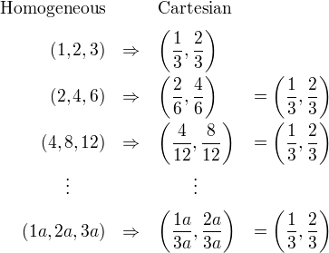

As mentioned before, in order to convert from Homogeneous coordinates (x, y, w) to Cartesian coordinates, we simply divide x and y by w;
Converting Homogeneous to Cartesian, we can find an important fact. Let's see the following example;
As you can see, the points (1, 2, 3), (2, 4, 6) and (4, 8, 12) correspond to the same Euclidean point (1/3, 2/3). And any scalar product(數量積), (1a, 2a, 3a) is the same point as (1/3, 2/3) in Euclidean space. Therefore, these points are"homogeneous" because they represent the same point in Euclidean space (or Cartesian space). In other words, Homogeneous coordinates are scale invariant(縮放不變性).
