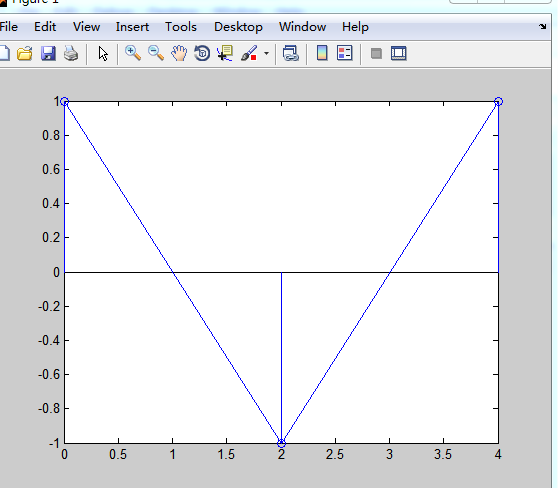

t=0:2:4;
x=cos(0.5*pi*t);
plot(t,x)
hold on;
stem(t,x)

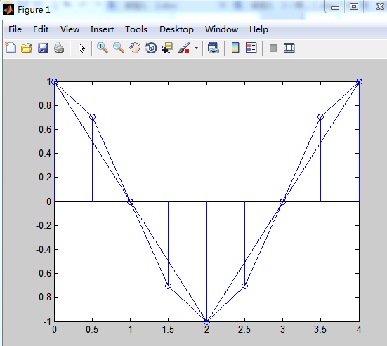

t=0:0.5:4;
x=cos(0.5*pi*t);
plot(t,x)
hold on;
stem(t,x)

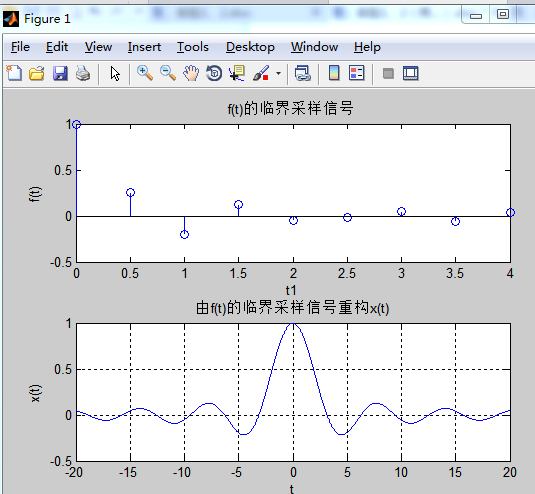

wm=1;   %升余弦脈沖信號帶寬
wc=wm;        %頻率
Ts=pi/wm;        %周期
ws=2.4*pi/Ts;      %理想低通截止頻率
n=-100:100;          %定義序列的長度是201
nTs=n*Ts        %采樣點
f=sinc(nTs/pi);    %抽樣信號
Dt=0.005;t=-20:Dt:20;
fa=f*Ts*wc/pi*sinc((wc/pi)*(ones(length(nTs),1)*t-nTs'*ones(1,length(t))));  %信號重建
t1=0:0.5:4;
f1=sinc(0.5*pi*t1);
subplot(211);
stem(t1,f1);
xlabel('t1');
ylabel('f(t)');
title('f(t)的臨界采樣信號');
subplot(212);
plot(t,fa)
xlabel('t');
ylabel('x(t)');
title('由f(t)的臨界采樣信號重構x(t)');
grid;
